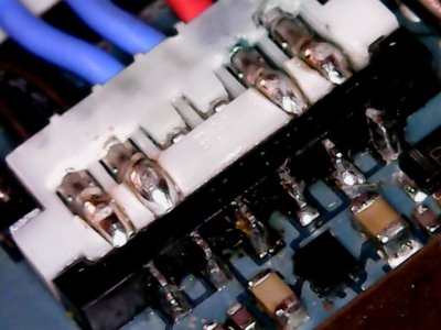

You can get help from repair shops but I don't think these guys know how to fix this tablet.
Trust me, in order to this tablet's problem , you need to understand the root cause.
You can send it to Samsung , they will give you a quote after evaluation. If it's too expensive, you can opt not to repair and return back to you. They might charge under $100 or just $65 if battery or battery connectors need to be fixed.
However, not even Samsung repair guys know how to fix this tablet properly.
I saw them fix problem by soldering battery directly to mainboard which is a dumb solution based on my opinion.
If the battery need to replace, it will be destroyed by the heat from solder iron. However, if you don't know if it's soldered directly to mainboard, try to take the battery out will break the battery connector from mainboard, you will end up to to replace the battery and mainboard
