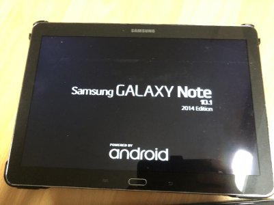

It's an obsolete tablet, you should consider upgrade to The Note 10.1 2014 or Tab A with Spen
Note 10.1 2014, SM-P600, around $200
Tab A with Spen, SM-P580, around $200
