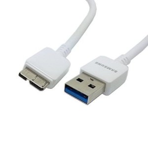

Well, I may have discovered something.
We all know the standard Samsung S5 cord:
I have tried my different cords, different outlets, etc., and my S5 has been tremendously slow to charge (as in, going from 15-40% over seven hours).
This afternoon I tried a different cord - one that only fits in one-half of the charging area. And it fit. And it works. And my phone is charging up like crazy (aka like normal). The cord is for my portable USB charging device that I got a couple years ago. So, I'm hopeful to get a phone fully charged, and determine if there is some kind of debris in the device that prevents it from getting a good charge when connected with the traditional cord.
Has anyone else ever experienced this? How can I check/clean out the battery charging dock?

Well, it may have been a combination of things... and although better, not perfect.
* Using the Micro-SD cable to charge the phone has been very helpful. I have been traveling, and not found someone to check the port for dirt/dust/etc. Hope to do that soon.
* With the Micro SD card, I am now able to transfer data from my phone to my computer. The previous cords I used would not be recognized by my laptop, so I think they either "wore out" or there is a port issue.
