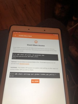

we will be following GSAM's in app how to for this. I've supplied a photo taken of the commands we'll be using a little later below, the photo is labeled 'grant gsam access'

connect your phone, you'll see a pop up on your device. tap ok. click refresh adb. now click adb shell. you're likely not going to see something in the resultant command window. type exit, you should now see a string looking like the last line in the screenshot titled 'adblink command'
assuming you've done it right so far..this is what you want to see.
be aware that from this point forwards, spelling/capitalization/symbol usage MUST be accurate or you wont see any results.
now type in 'adb shell pm grant com.gsamlabs.bbm android.permission.BATTERY_STATS' and if done correctly you should see two things. in the command shell, it'll return you to 'C:\Users\-insert user here-\Desktop\adblink\adbLink\adbLink>' and on your device you can now tap the little funky checkmark and SHOULD now see a detailed breakdown on what exactly is using the most battery at any time.
the second command in that screen shot goes further, and should only be used if you want really detailed results, with the caveat of other apps being able to access hidden system api's as well as gsam.
