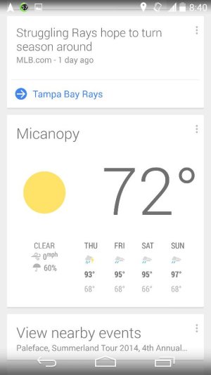

My phone keeps doing this. I'll have full bars but no LTE, 3g, or 2g. Anyone else have this?

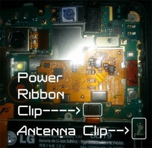

I experienced this issue as well.
I tried the following which seemed reasonable, but did not resolve; i was still stuck with "no service" "emergency calls only".
  • Reboot Nexus 5
  • replace sim card with another phone's sim card (but then a least i knew it wasn't an issue with the sim card)
  • re-seat battery (requires very small phillip's screwdriver: pop back off, remove six screws, unclip and reclip power ribbon clip)
Then this worked for me:
re-attach internal antenna!

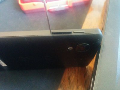

Sim card removal with sewing needle:
Nexus 5 coverplate (requires six very small phillips screws to be removed):
Nexus 5 antenna clip point and power ribbon clip:
A small screwdriver set, in this case a Radio Shack 04B14 set:
HTH!
