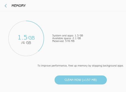

My Tab S3 really slowed down after the October update when my reserved memory dropped from 704 mgs to 376 mgs. Graphics really 'stutter', browser pages load slow (wifi).
My Husband hasn't installed the October update yet (postponed) & his reserved memory is still at 704 mgs. His Tab S3 doesn't lag at all.

I went to Best Buy to check a new Tab S3 that had not had received updates & the reserved memory was the same as my Husbands.
Huh, interesting. I did the update too and my reserved memory is 376 as well. Maybe too much a coincidence to not be considered.

What I'm ignorant about, is HOW to check it.
Settings
Device Maintenance
Memory
That will show you the current memory. I don't know if there is a way to tell what the reserved memory was before the update. That's why I checked my Husbands device & a new device from Best Buy. Neither device had been updated. And as I mentioned previously, @milleniumdroid commented on this in a few posts.
