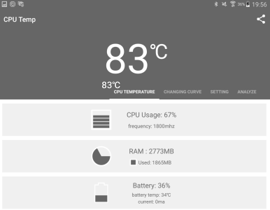

Now i think more in the lines of overheating. When playing a game like HayDay the average temp is 72 degrees celsius which seems quite high to me after maybe 5 minutes playing. Any ideas on that ? The tables has the Exynos 5420 processor, i that known for overheating ?
I used a CPU temparature app form the Play Store.
72 deg Celsius is pretty darned high -- that's 161 deg F. Does it actually feel that hot? If so, then I'd suspect some problem with the motherboard.

No Sd card in the tablet, the 72 celsius is only average. It will go over 80 regularly. I might look to find the processor, is this cooled like a desktop processor with some hear spreader ? Time for some open heart surgery.
But does it actually feel like it's getting as high as 160 deg F? There might also be a faulty temp sensor.
Yes it does, and how ! When I remove the back cover and touch the metal plate on the left (I guess that's where the processor lives) with the skin of the top of a finger I can hold it there a maximum of 5 seconds before it's just too warm.
