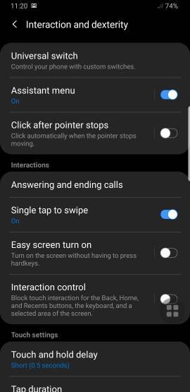

Settings > accessibility >interaction/ dexterity > toggle assistant menu
Then the floating notifications drag all the way up to your top screen and hold until it disappears

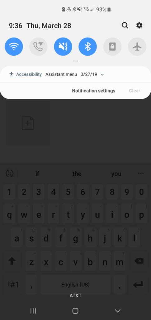

Yay! Single tap back, floating button gone but if you swipe down to see this.
Anyway to make that go away? Not a big deal if not but didn't know.
Hi I realise this thread is kinda old but I found the solution.
Do this exactly: Turn on assistant menu. Turn on single tap mode. Do NOT hide the floating menu icon. Navigate to settings-> apps-> 3 dots and show system apps-> assesibility-> scroll down to "appear on top" and tap-> turn off permission-> force stop accessibility.
Now you should not have floating icon or notification and still have single tap. How this works!
The floating menu comes back when the phone restarts...
Yes that is the only flaw. I just force stop accessibility after every restart. Haven't found a way to permanently remove icon.
