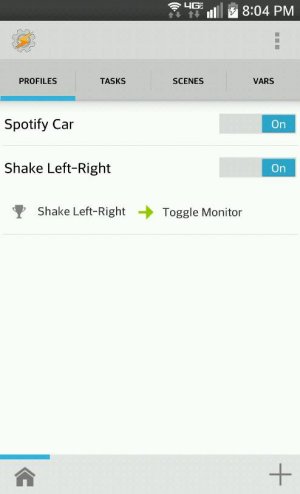

Finally been able to have Tasker to start the Bluetooth service, connect to my car, open Spotify and then begin playing whatever playlist is open. I generally play my "starred" list anyways, so it works. I did use three plug-ins that made this much simpler than it could have been. There were some examples on the Web, but none worked really well, or didn't begin playing automatically.
The plug-ins were
Bluetooth Auto Connect.. used as a standalone before, and probably not absolutely necessary as my car does connect automatically, most of the time . Still this app has always been more reliable.
Media Utilities.. Made it super easy to play from Spotify.
Autolocation... Used to detect when I am in a vehicle. Critical again. I could have used the AC plugin as the state, but that would require me to plug my phone in every time. I also set it up with a shake gesture to toggle the activity monitoring service.
of course I could have gotten some nfc tags, but what fun would that be?
Attached are the states and setup for each. I am certain there's much more I will want to tweak or add, but it works for now. This is an incredible tool for a phone. I know I would like to add a widget or notification to tell me the monitor state...Maybe another day.
