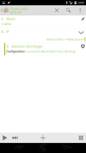

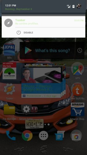

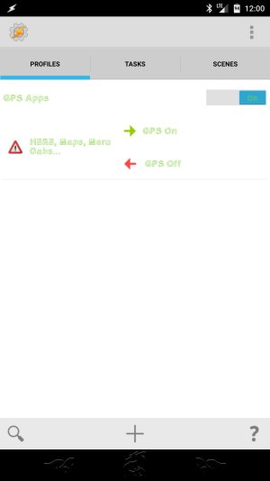

Ok, so I think I imported the XML file directly and import into tasker. But when I went to google maps and asked me to put high accuracy GPS mode on I said ok, when I exited out of it I waited a few minutes for the time out from Tasker but it did not work. Am I missing something? Attached are some screenshots to show you what I'm saying hopefully it'll help you out. Thanks again.uploadfromtaptalk1441555365471.jpguploadfromtaptalk1441555375271.jpguploadfromtaptalk1441555382276.jpg

Ok, so I think I imported the XML file directly and import into tasker. But when I went to google maps and asked me to put high accuracy GPS mode on I said ok, when I exited out of it I waited a few minutes for the time out from Tasker but it did not work. Am I missing something? Attached are some screenshots to show you what I'm saying hopefully it'll help you out. Thanks again.View attachment 195332View attachment 195333View attachment 195334

You need to have root access to change any location settings.
