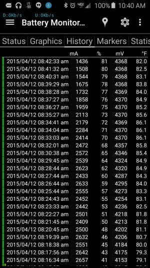

Normal as the charging rate drops near the top.
Sent from my Pearly White Verizon Samsung Galaxy S6 Edge
This is from regular(not wireless) charging but it illustrates the point
