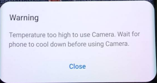

When I am using Samsung Galaxy Note 8 camera to take video, sometimes after taking videos for about 15mins or more, it shows this message "temperature too high to use camera. wait for phone to cool down before using camera." Default camera app auto exit and I need to wait for it to cool down then I can use the default camera app again. I missed some info that should be recorded due to this problem. How to solve the problem?
When temperature is too high I have tried using another app called Open Camera for a few seconds and it works but I am too afraid of damaging my phone so I did not use any camera and let the phone cool down for about 10mins minimum then try to use the default camera app again.
