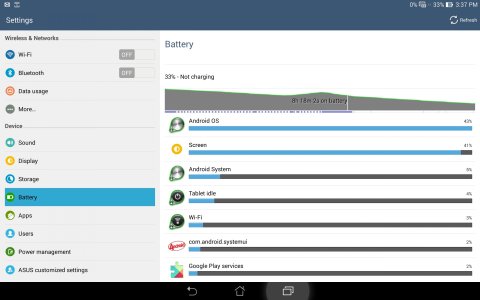

Hello to you all,
I experience this excessive power drain too since last week, caused by the 'Android Operating system' and increased wifi activity in stand-by/sleep mode with screen closed.
In my case the power drained from 100% back in 15 hours of NO use to 4%! As I could work for over 2 to 3 days for many hours a week ago....
The power graph is almost similar to the ones I find here, but with one big diffenrence: In my case I see 4 to 6 power spikes peaking up to 100%, wich is impossible because there is no power supply connected.

This problem started about 2 weeks ago and android os now often shows higher drain than the screen! I stopped/uninstalled every app I could think of, removed SD card, disabled WiFi and battery was still draining about 8%/hour when not being used. Finally did a full factory reset, charged to 100% and battery was down to 92% after 1 hour of idle. E.g. no freaking change!! The only thing I'd setup was email.

I installed GSam battery app, and this one shows me that the Android Kernel OS consumes up to 52% ?
