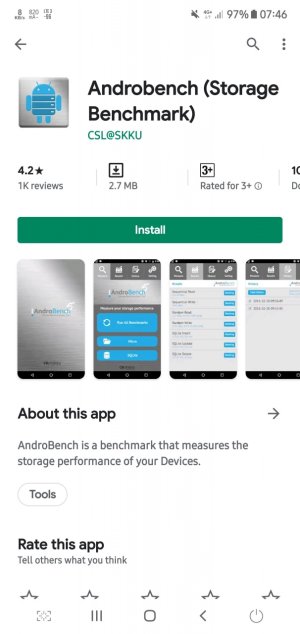

Why would you suspect its fake?
I usually use this app.
