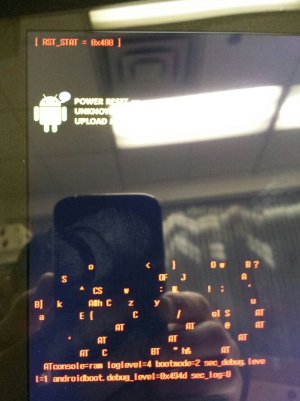

This is what I got when I booted into recovery with Power, Home, and Vol Up:
And this when I pressed Power, Home, and Vol Down (which is what tech support told me to do, which I knew was wrong):
Clearly, it's been rooted?
The tech support guys probably left the device in 'service mode' or something like that. With their dongles (no pun intended) they're able to gain root access since they need that to overwrite files and do updates and firmware stuff, so maybe the tablet acts like it's rooted.

Looks like it was a bad flash from tech guy and recovery/bootloader is corrupted. In download mode KNOX isnt listed either. Real bad job, by whoever did it and didnt bother to check before shipped it back to you.
It's not necessary means device is rooted, some OTA does change to custom too or SDcard inserted that contains rooted files.
Mail Samsung support these pictures and ship it back to them is the best thing to do.
Normal, you can "restore" it back to normal status, by download stock ROM and flash it with Odin. That probably Samsung techs guys gonna do, when ship it back to them and since recovery is "corrupted". Best is to ask them first and hear if you can do it u self.

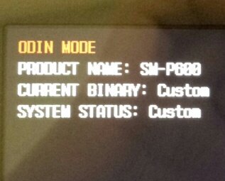

This should show in download mode (ignore Qualcomm secureboot, since I have LTE version):

After a few run ins with support, I finally got someone who knew what they were talking about. He suggested I do a firmware recovery via Kies in Odin mode, which is happening right now. There's no counter, so it looks like it was a sloppy job installing the firmware by the repair guys. Whatever they did didn't trip Knox.
BTW, the guy (who sounded like Matthew McConaughey) said any OTA update should install normally after this, but he didn't have an OTA version of kitkat to confirm. When I said, "no *OTA* version", he chuckled and said, "yeah, no *OTA* version" . So it looks like 4.4 is definitely being tested right now.
Okay, I'm back in business. The Kies update worked. It's now the Official version, so OTA updates shouldn't be a problem. Thanks for the responses.

Download Kies 3 from SAMSUNG KIES and install.
Make sure your tablet is fully charged, then power off. Press and hold down Home+Vol Down+Power (it's easier to hold down Vol Down and Home together then press power last).
You will get to the custom firmware screen. Press Vol Up to continue to Odin Mode.
Open Kies 3.
Connect the tablet to the PC. It should connect it Kies after it fully installs the driver.
Go to Tools|Firmware Upgrade and Initialization. The Model name is SM-P600 for wifi version. The model number is listed in Odin Mode if you have a different model. The serial is tricky -- if you still have the box, it's on a little sticker (the same one used to redeem rewards). If you don't have it, call service to get it. I don't think there's a way to get the serial via the tablet software.
Just follow the prompts to kick off the firmware replacement. As you can see from my screenshot above, this did not trip the Knox counter.
