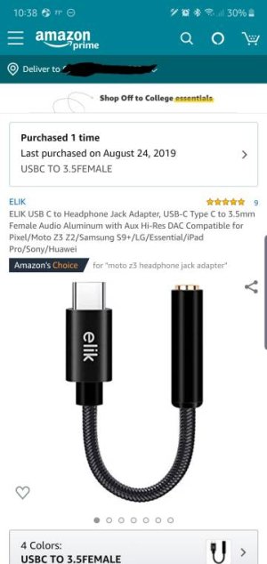

DAC is the missing piece of the puzzle. I ordered these and all is well again. I can use wired now.
