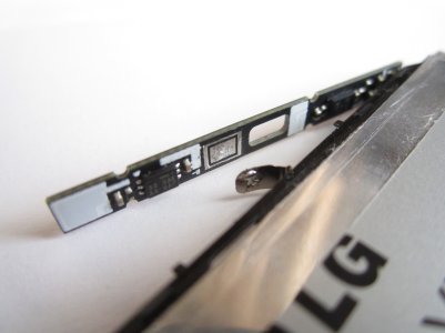

I got a re-furb G3 from Ebay seller, it began to show "random re-start" bug AND power-down (requiring removal of battery & power-on). I asked for a replacement battery (mfr date 14.08.04 -- pretty old!) -- it was even WORSE! It showed the "boot loop" bug. Note that the G4 (internal battery) also had the "boot loop" bug
^^^ the problem is manufacturing BUG in G3 battery -- using greyish-compound ("glue") for the "+" contact to battery control board.
Temporary fix:
use paper-shim (applies pressure at the "+" contact, where compromised electrical connection is -- due to "grey compound" (glue)
Permanent fix:
Use soldering iron to remove "grey compound", & solder the contacts in.
See attached image
