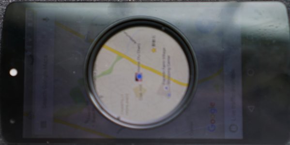

A circular polarizer, often used by many (D)SLR camera users, can change the polarization from planer to circular. Hence may help in this case.
Update: here is a proof of concept of mine. On the bottom is my Nexus 5 in landscape orientation. I put one of my circular polarizer on top the screen in the middle. Then I took this picture through my polarized sunglass. You can see the portion of the screen inside the circular polarizer is much brighter than other areas which are darkened due to polarization. DSC04882.jpg
Great example!
A third (circular this time) polarization film is applied to things like fish finders (it gets bright out there) to make sure it can be seen from almost angle and it's bright.
It's also possible that some high-end phones have a separate circular filter over the display, but I don't know of any. Since it has to be the top layer of the display, it would need to be really thin high-grade glass to register touches. Probably pretty expensive
