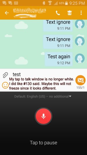

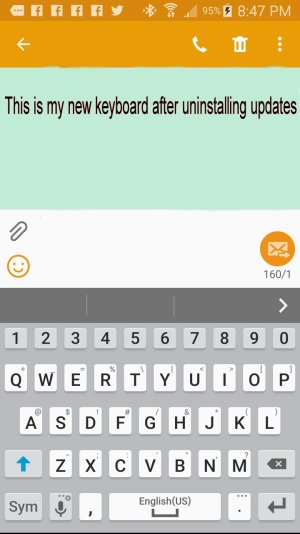

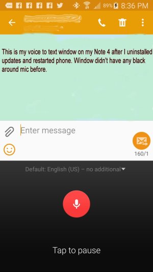

THIS FIXED FREEZING! I have the Note 4 and this is how I fixed my voice to text screen freezing.. I went into Settings by swiping down ( settings button is the little wheel on top right) then Applications, then to Application manager then to downloaded apps and scroll to Google App, select "uninstall updates" THEN go to Playstore , select menu on the left ( it is the three lines) then scroll down to settings, then set "do not auto update" This will keep your phone from updating the google app with errors all over again.
Note* When I did the above I lost the mic on the keyboard so I REBOOTED my phone. Now my Google Voice to Text window is black instead of white.
Here’s how I confirmed that my Voice to text won’t freeze again and IS FIXED. If you can force your phone to freeze by doing the steps below then your phone isn't fixed. I have been FREEZE FREE for 24 hours!! I Can’t replicate it like below so problem solved:

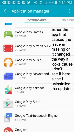

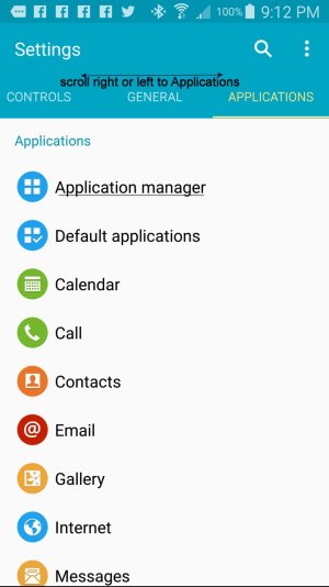

I completely disabled this function by uninstalling it as none of the other suggestions worked permanently - on Galaxy S5 go to Settings; scroll all the way down to "Application Manager", find the Google app, and uninstall (you can also disable, however I did this once and somehow the problem came back)

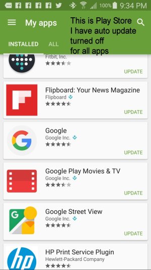

If you do not go to PlayStore after you uninstall updates and select to "not auto update" it will always come back. I had to reboot my phone after that to get my mic back on my keyboard. Knock on wood cause mine seems to be back to normal!
BTW when I went into the apps manager and uninstalled and the whole routine. When I went back into app manager after restarting my phone the app wasn't listed any more. So I feel certain I am bug free :)

I am attaching three more screen captures for those of you that are visual learners.
After you go to the play store and select to not auto update you must restart phone for the mic to show back up on keyboard.
To confirm you phone is fixed try to replicate it by doing this: But if your speech to text window is black you are good to go.
