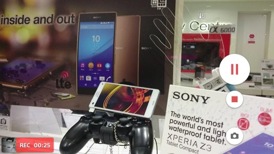

In the first scenario, we're assuming that someone was using the Z3+ for some time and somehow wanted to take a video of some scenery or something. The unit was running for some time, exactly how it would be like if it was used. I fired up the camera, put it in 1080p60 recording and did a test recording.
After about 25 seconds, the thermometer showed up on the viewfinder, telling me that the phone is heating up to abnormal levels. The phone didn't have a case, so it did feel pretty warm.

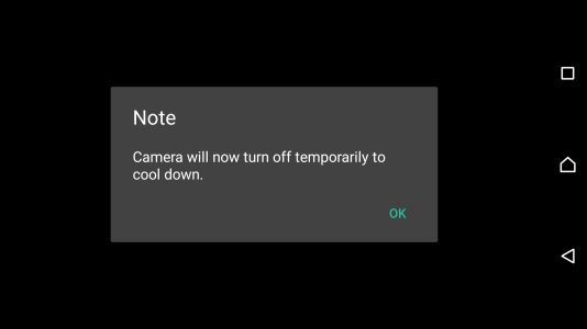

About 30 seconds later, I was greeted by the following screen.
Okay, so 55 seconds of video recording on 1080p isn't so good. But, I'm not ready to write this phone off. I had a second scenario in mind, one that is more common. I'm also assuming direct sunlight in this scenario, so 100% brightness.

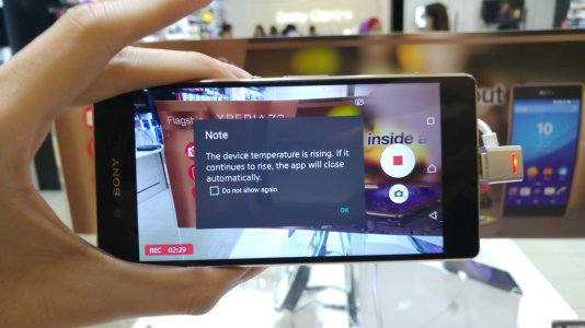

Once that's done, I did the same recording test. On 1080p60, it didn't have any issue and passed the 3 minute mark with no issue. I cooled the phone for a consistent result and cranked it up to 4K UHD recording mode.
For a while, everything seemed fine. The phone recorded fine and no ill-effects were seen. After the 2:30 mark, the phone gave me a message warning me that a camera shutdown was imminent if I don't stop recording.
I proceeded with the recording and for some reason, the camera managed to exceed 5 minutes on 4K, but I had to stop it as most phone cameras stop recording 4K at 5 minutes. Once I did that, the phone greeted me with this.

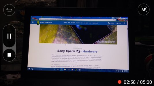

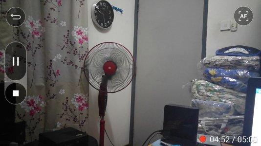

For those who don't know, my current daily driver is the LG G4, which uses a Snapdragon 808, which is a little less powerful than the 810. It has a more favorable reputation as it doesn't heat up as much. But in the interest of a fair comparison, I put my personal G4 in the torture chamber and proceeded with a recording test in 4K.
The phone was idling, so I had to increase the display brightness to 75%, plug it into the charger and connect to Wi-Fi. I also had to use the phone a bit to get it a little warm in my best effort to mimic the same conditions I tested the Z3+ in.
On the 2:58 mark, nothing seems wrong.
It went all the way to 4:50 with no message.
The recording ended at 5 minutes, with a message telling me that recording in 4K is limited to 5 minutes due to temperature limits, as it was designed to do.

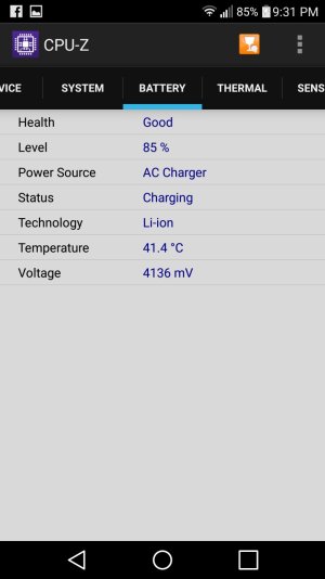

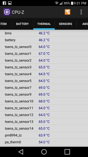

It's still a bit toasty, though, but didn't feel overly uncomfortable.
