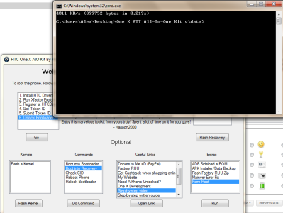

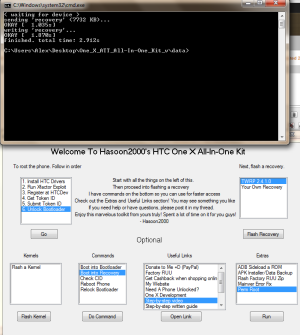

so guys i dunno if im in the rigth section, but im totaly new at this, i had managed to unlock the bootloader, but im stuck there, using the hansoon htc onex all in one i flashed recovery 2.4.1.0 (or so i taugth, but i dont know if it really flashed, because on this video http://www.youtube.com/watch?v=9b-BR...4vWi0A&index=1 the celephone reboots itself, mine didnt, look at first picture) then the guy goes to perm root, and i do to but nothing happend just what what you see on the picture 2).
Can i get some advice? as for now im sure that i have just unlocked the bootloader, as for everything else i have no clue (i cant get into recovery mode, so i haven flashed correctly yet rigth? so obviously i havent been able to enter into recovery mode and flash it.
so i think my problem is that im not flashing correctly recovery mode, but what could i be possible doing wrong? it seem so easy on the videos
help plzz!:(

The second command window is what you see when you see when you try to flash TWRP Recovery? Because the first one would indicate success at flashing Recovery. Can you get to the bootloader screen, either using the tool or the VOLDWN+POWER button code? If so, what happens if you select RECOVERY with the VOLUME key and hit POWER to select? If you can get to recovery, hit the mount option to connect USB and copy over the custom ROM you want to try. If not... I would reboot your PC to clear any problems with your USB communication, and try the tool again. If THAT doesn't work, we may have to get Recovery on there with Fastboot. It might be something as easy as a reboot of your PC though. Some of the flashing stuff I have seen cause USB issues on mine, and need a reboot to start over.
TIP- It works easiest for the button code, to power your phone off. Hold VOLDWN down and press power. Keep holding VOLDWN until the bootloader screen shows up. Use volume keys to move cursor and power to select.
