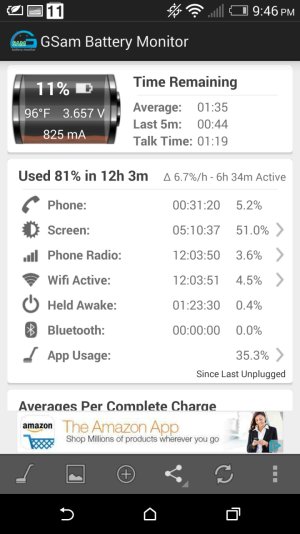

So I got my M8 about two weeks ago and straight out of the box I noticed that I wasn't getting the stellar battery life that all the reviews raved about. With decent usage, 10-12 hours unplugged, and 4 hours of screen on time I was down to below 15%. I contacted HTC and they told me to do a battery calibration and reset the battery. I did that a few days ago and although I am noticing better battery life I'm curious as to if what I'm getting is still subpar to what some of you other M8 users are getting. I got an extra hour of screen on time and did so using the phone quite a lot (light gaming, quite a few YouTube videos, 30 minutes of total phone calls, chatting, web browsing, and a ton of texts). I am on Sprint (yes, my life sucks, I know) and don't have great signal most of the time so I know that, but I am on WiFi for most of the day. Please help me out and let me know if what you see below is normal and is pretty much the expected or close to expected life for the M8. Thanks!

I'm not complaining about what they offer, I just get really bad reception, causing my phone to constantly strain to get a better signal, which in turn has an affect on the battery. And I've had my phone for a couple weeks and have done a battery calibration. The GSAM report above is what I got this past day. Does the battery life shown look normal? How does it compare to yours if you don't mind me asking?
Yeah, that's good battery life, especially considering that you were gaming and watching video. Looking at that I wouldn't guess at all you had significant drain coming from low reception. That being said, the M8 does seem susceptible to drain from cell radios. I got mine when I was still in my dorm for the last semester, my room had awful reception. I was getting pretty terrible battery life, the voice and text stuff you can't turn off drains a ton of power, not just data. As soon as I moved out my battery life went up by hours, to about what you're getting.
Again, that looks good to me. But if you want to do a test of how much the low reception is affecting you, put it in airplane mode with Wifi on and just use Google voice for texting if you need that for a day. See how that goes.

5 hours or more of 'screen' time is good, but always compare GSAM against the system battery monitor. GSAM sometimes overreports screen time.
