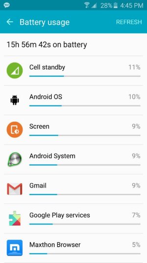

I must say my cell standby seems to be going crazy too. This is definitely not an improvement in battery management. I think I like the phone better before the update.

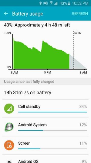

I'm up to 34% cell standby drain and I basically haven't been using my phone today (my last day home with my 2 week old daughter) before I go back to work from my paternity leave.
I'm scared to see what happens once I'm using the phone all day.
Who do I complain to? TMO? Samsung? Google?
I've already wiped cache twice.... Might factory reset tomorrow morning unless anyone has any other suggestions. It just really bothers me that I've had Zero Cell Standby issues before this update.

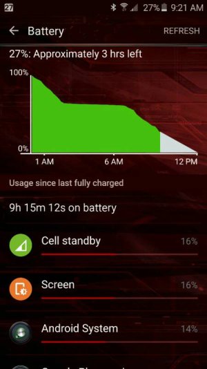

Oh I agree to a point. Even I can replicate the cell standby bug if I have everything turned on full blast (wifi scanning always, location history on, VoLTE on, etc). But my worst cell standby on a single charge was 16%.
But in no way could I ever replicate the extreme cell standby issues that will be had when wifi calling and VoLTE is turned on with a T-Mobile device that gets anywhere from 30%-60% cell standby on a single charge. THAT is what I'm talking about that needs to change, and it will only change once T-Mobile fixes the wifi calling/VoLTE issue in their software. (one person in just this thread is claiming 5% per hour of cell standby. That's 30% in just 6 hours. No, I can't replicate that at all, and I've never seen anyone on any other carriers replicate that as well.)
Below is a pic of my worst cell standby that I got with everything on full blast and both ADM and Samsung Security turned on and running. 5 hours of SoT while gaming and YouTube/web.
