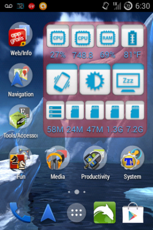

Re: Optimus V: Internal KitKat with mount scripts
I do have the old launcher working again. Here's a screenie with my favorite widget showing partition free space as well. Great for these scripts: Elixer Widget.
