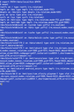

Unfortunately, "Storage Partitions" doesn't work with my VM670 Mirage ROM (2.3.7) phone. I downloaded AParted since it was the first response to my "Storage Partitions" search, but it doesn't seem to do what you/I need. Is there another way I can determine if my Mirage phone is set up properly? In a bit of serendipity, I got blocked from downloading a 50mb app because I only have 67mb of free space on it, so I'm willing to backup and do a clean install in order to use your program. Or should I just roll the dice with it and see if your program works as-is?

As for your second question, download "terminal emulator" app and type "mount" (no quotes). Will be an overload of info, but you should be able to find it in there. Let me know. I will likewise after I make the new script version.

In the meantime, I tried to use the terminal emulator on my Mirage phone for the data you requested, but it's all jibberish to me. I THINK it is what you require (5 is data, 6 is system) but since I didn't see any of the other stuff I saw using your program I'm hoping you can take a look at the results and confirm that I'm gtg:
Sorry I didn't get to reply. Up I the mountains all data outta cell signal. When you reinstall from scratch, try just the modified Toucanscrypt alternate, not the wipecatch or others as they may need some editing to work as well. As far as your mirage phone, it looks like it should run fine with the default files. Give it a shot! Won't know till you try as no one to my knowledge has tried it with Mirage yet!
