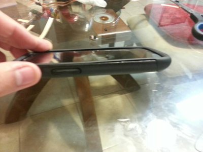

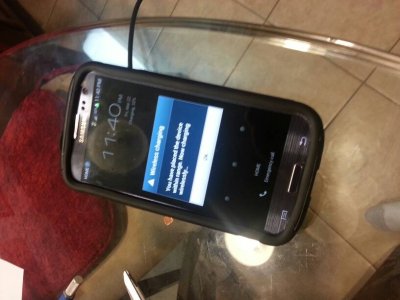

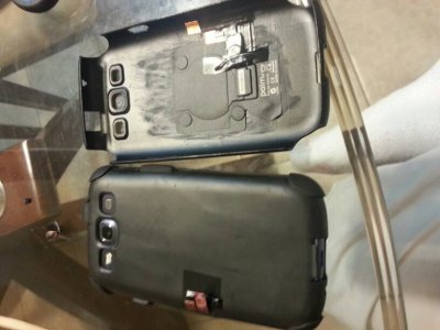

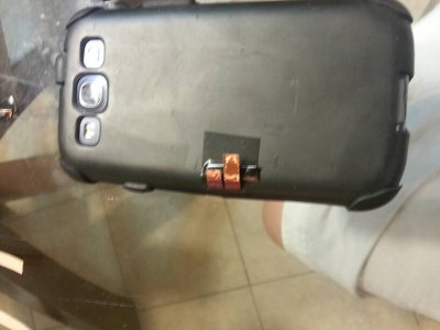

Well after 3 days of messing around, sanding, fitting , and wiring I got my touchstone wireless charging working. The awesome part is that I have my otterbox case on it.. I'm loving it.
