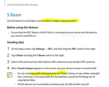

I never tried to send an mp3 via NFC/ Sbeam/WiFi Direct until you mentioned not being able to. I noticed the manual doesn't include "music" in the description of what you can send. (see below) I think it has to do with copyright laws.
I turned on my old S3 and tried to send an mp3 filed from my S5. the NFC/Sbeam didnt' work . the WiFi Direct didn't recognize my s3 . the only way i was able to send was via BLUETOOTH.
hope this helps
