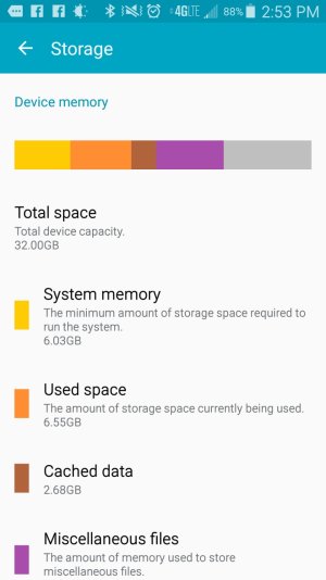

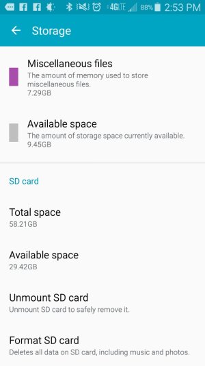

Was the device powered off when you installed the new SDCard? I'm assuming the SDCard came pre-formatted with FAT32? Can you post a screen-shot of what your "Storage" settings look like? You should see something like this:
