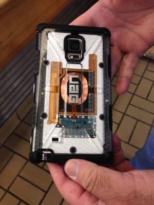

Problem: oem wireless back doesn't fit most if not all snap in cases due to it being deeper than oem backplate.
You can take the oem wireless qi charger out of the oem wireless backplate and fit it into an oem or wallet backplate by removing the outer shell and inner shell.
I have the oem wallet case which did not protect my phone last week from a fall and it cracked. Asurion replaced phone with new phone and I ordered maverick uag case.
Wireless oem back arrived in white (black more expensive and I was going to canabalize it anyway so why bother) but would not fit maverick case well(If you tried using oem wireless back instead of oem back because it was thicker).
I took off the outer shell and the qi receiver sits on a smaller piece of plastic that is attached to outer covver. This case was white and the white that you see is the inner plate of the oem wireless back plate. This perfectly fits inside of any snap in case without cutting the coil and board out of the inner plate. Since the uag case is see thru you can see the inner plate and looks very cool so I left it that way.
I did mod a second wireless qi oem receiver ie removed it from plastic shell front and back and placed it in oem wallet cover for a friend.. it has no bulge and works perfectly well. that would allow one to use any case with charging oem coil...
Thanks for asking...
