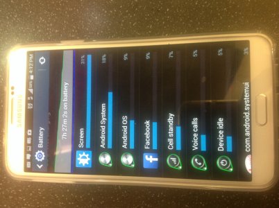

Just a quick update guys.
I manage to pick up a genuine Samsung battery last week and so far I've not notice any changes.
I unplugged the phone at 9 today and at 16.00 it's sitting at 58% surely the there's something draining the battery. image.jpg

I'm sorry to here but I'm on 11 hours of heavy use still have 54% juice left and that's 1/4 brightness level

You can take screenshots of all your settings pages, just wipe over any personal account email and IMEI number.

Hi guys... I gave up in the end and decided to factory reset my phone. And now the battery is lasting around a day and a half. Very pleased. Thank you guys ever so much

You phone dropping 2% when taking it off charge is normal to me.. Mine does that without using it sometimes. Just means if you let it drop to 1% it lasts longer then

I unplugged the phone at 9 today and at 16.00 it's sitting at 58% surely the there's something draining the battery. View attachment 108416
You think that's bad? it's not if you are using it Abit
