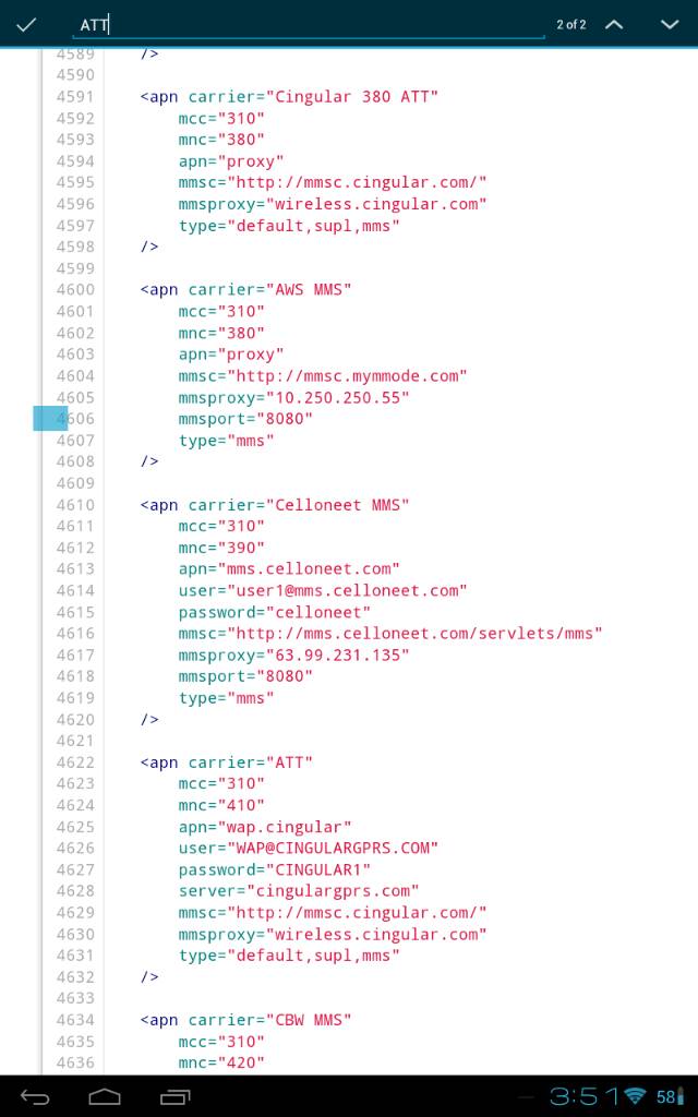

Please try the two ATT ones in the picture below
Sent from my SCH-I815 using Tapatalk 2
