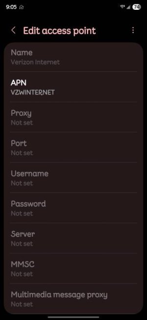

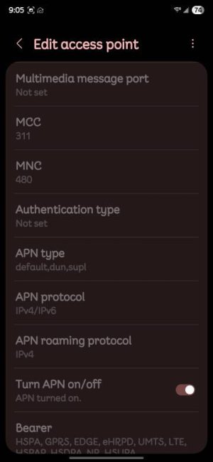

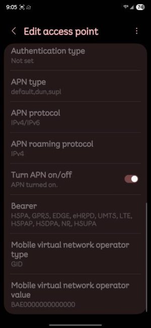

I have an unlocked S25 Ultra purchased directly from Samsung. I am on Verizon and use eSim. And I use Textra. I have had no issues, I'm glad to say. Not sure it's of any help to you but for comparison, here are screenshots from my APN screen.
View attachment 369747View attachment 369748
Did all 3 grabs attach? I'm only seeing 1 pic but the links for the other 2 are there.
You ninja'd posted. What the hell is dun in APN Type.. It should be default,mms,supl.
Also you have no MMS port set, should be 80.
Also not seeing the MMS Address (MMSC).
Edit, actually im not sure with 5G switchover port is still needed.
MMSC should be though: http://mms.vtext.com/servlets/mms
Did you manually add that APN info or did some of it auto populate?
