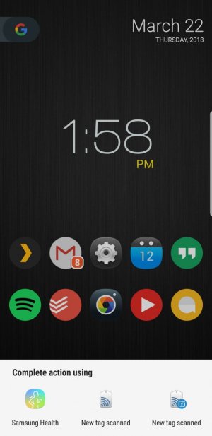

S8+ .. just updated to Oreo this AM .. since update each time phone is unlocked with fingerprint or pin, I get an annoying pop up at the bottom of the screen that says ..
"Complete action using .. "Samsung Health", New tag scanned", "New tag scanned""
(I have no idea what this New Tag Scanned thing is.)
I can't figure out what setting is causing this .. I use Nova Launcher .. tried changing back to default Samsung launcher, but no change.
Any ideas would be appreciated.

Under SETTINGS>>CONNECTIONS>>NFC and turn off NFC.
After that .. the popup issue disappears. Re-enable NFC and the problem returns.
NFC must be enabled for Samsung Pay to function properly, so this is not a solution .. but it does point to the issue.

Go to Settings>Apps, then tap Menu>Show System, and look for Tags. If you see it there, try Disabling it.
I've been experiencing this issue as well for the past week since my S8+ updated to Oreo. It did indeed stop after turning off NFC but this wasn't ideal. I've narrowed this down further, when NFC is enabled and my phone isn't in its case I don't get the complete action using popup. This was because I keep my mastercard in the card slot of my case and it uses chip technology which is trying to be read by NFC on phone unlock.

Do you have a card with a chip next to your phone? I have a wallet case and this issue started happening with Oreo. When I remove my card, no more popup. Hope this helps.

Ho, i am a boy from sweden and i am 14 years old. I think i know why this happens all the time when you log in to your phone. I tried if the cards i have in my phone holder had anything to do with it. And i noticed that it was only my travel and my gym card that got it to activate the "complete action" thing. So my tip is to try remove your cards from your phone holder and try which cards that it works with. I never get these pop ups and more.
