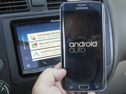

I noticed an update of the Android Auto app this morning and decided to try again on the 4100NEX. Lo and behold, it worked! Well at least partially :)
The interface comes up and seems fully functional, but there seems to be no sound coming through the USB interface. There is sound for phone calls (which I think is bluetooth), but Music, navigation and all other sounds do not seem to work.
Also, the phone is no longer locked when in AA mode, i.e. I am able to navigate, open apps etc. while connected to the car (just like on Apple).
I have not yet updated the firmware update to 1.03, so will try that next and see it it helps.

GS6 now works fine. I'll update this thread title accordingly. :)

Had a feeling about this. It was Google Play Services.
Can't post links but see here w w w(dot) androidcentral.com/latest-google-play-services-update-enables-android-auto-galaxy-s6
Rollout happens automatically but if you're adventurous the APK is out there.

Also to confirm updating to the 1.03 firmware fixes the sound issue.
