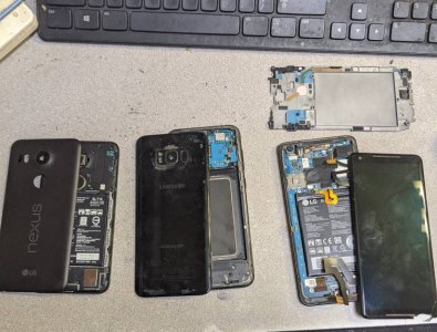

Yeah I have few projects going myself
To left is my nexus 5x I put battery and charger port , need a mother board though
Middle my s8+ needs battery back glass
Far right my pixel 2xl needs battery and front glass.
Pretty cool.
How tedious was disassembly for these?
All screws, snap ons or glue too?
Nexus 5x all screws and pop off
The s8+ screws and heat gun get the glue soft , same with the pixel 2xl , for pixel 2xl no matter how careful i was and good heat i cracked the tip of the front screen

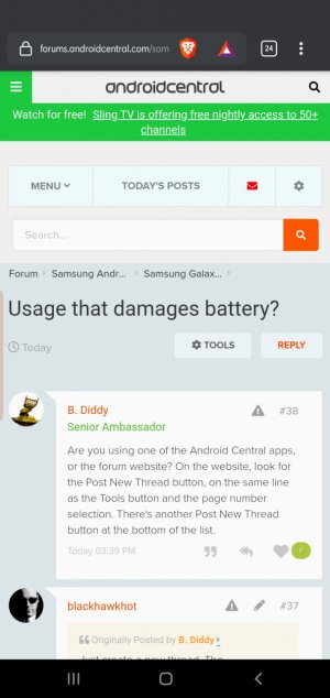

Are you using one of the Android Central apps, or the forum website? On the website, look for the Post New Thread button, on the same line as the Tools button and the page number selection. There's another Post New Thread button at the bottom of the list.
Huh. Still not finding it.
Not the easiest site to navigate in some respects.
Here's what I'm seeing:

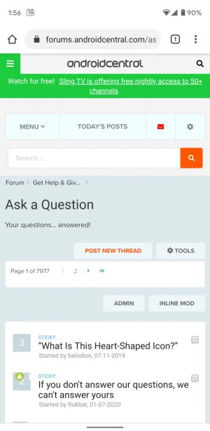

Go back to the forum thread list -- you won't see a Post New Thread button while you're within a thread.
