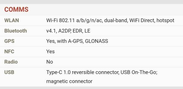

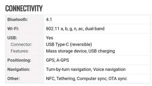

I'm not Jerry, but I Googled and this is what I found:
This. USB-C is a connector body and power transfer standard. It can use USB 2, USB 3 and USB 3.1 for data transfer. I'm not sure what the USB speeds are on the Z Force, but a quick check on Google shows me people claiming it's USB 2, USB 3 and USB 3.1 so somebody is lying :p
If your speeds were using a USB 3.x drive and a good cable (10 Gb/s and possibly a USB 3 or 3.1 label on it), it appears that the Z Force is a USB 2.0 device. I've never tested it so I can;t have much input here.

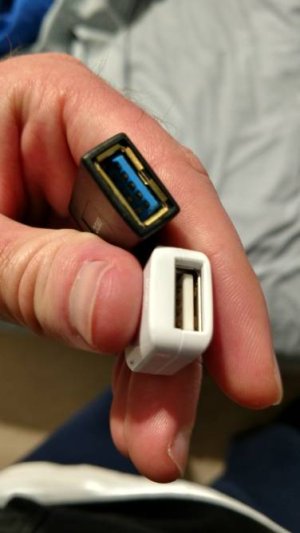

Come to think of it, I do have another OTG for USB C cable (from amazon in fact), right here at work! I'll check it out tonight and see if I get 2.0 or 3.0 speeds!
Thanks Jerry... I think I found my new favorite forum.

I was excited to see my other OTG cable having the blue tongue that is common on USB 3.0 devices or ports, thinking if my other samsung OTG adapter was the culprit, for sure I would see 100+MB/s on my phone. But alas, not the case, still in the 20-30 MB/s range. Must be that the Z Force is actually a USB 2.0 port... bummer.

Exactly. This is about what everyone sees and why some people say it's 3.0 and others say 2.0
I'm thinking that it's 3, but the software and storage controller are just slow. I'll see if anyone here on the team knows someone at Moto well enough to just chat and get some non-PR person answers.
