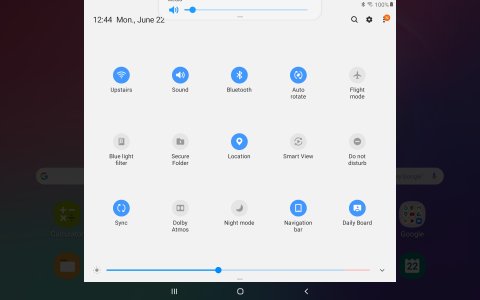

AhSo! Didn't know about that notification panel. I've read through the owner's manual several times but my poor old brain ain't what it used to be. Anyway, how do I take a screen shot for you and how do I upload it to the forum? If it means anything, the panel doesn't change no matter if I'm plugged into the controller or not. The controller communicates with FTDI on serial, so I have a serial/USB adapter. Perhaps my adapter isn't compatible.

That's the Quick Settings toggle panel, which you typically see if you swipe down with two fingers, or swipe down with one finger two times in a row. If you just swipe down once from the top of the screen with one finger, do you see any notifications there?
