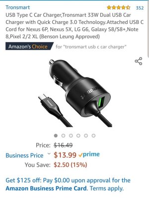

This is the one I used , the USBc was finicky but the other port which is USB work without issues
That's a useless charger, IMO, unless you like only slow charging your phone. These days, a USB-C PD charger is a must. It is the modern standard for fast charging. Pixel 3, iPhone 8 or newer, many new laptops can all charge from USB-C PD. Only USB-C port can deliver PD, not USB-A ports.
Disagree with you there, fast charges all my phones and it has a slot for USB to usbc and usbc to usbc . I've had it for little over a year .
Pixel 3 only fast charges on USB-C PD. Nothing else. I'm not talking about other phones that may support Qualcomm's Quick Charge 2.0/3.0
It rapid charges my pixel 3xl and 2 xl
If you like proof I'll be glad to make a screenshot for you later when I get home?
