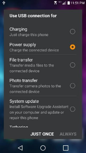

So I thought I was having a charging issue (USB menu keeps popping up) but upon researching this on Google it seems to be a bug on a couple of LG phones. I've tried a few of the troubleshooting steps but so far nothing is working for me. Here is what happens...when plugging in or unplugging a USB menu pops up (attached).... I click the option to just charge this phone but the notification keeps popping up. The frustrating part is the notification noise every hour or so all night long while trying to sleep. Also it randomly responds or doesn't to various charging cords now. Just wondering as a last ditch before I try a factory reset (which people say unfortunately doesn't work either) if anyone here has experienced this? I think I'm gonna have to get a replacement but am not happy with the thought of a old refurbished phone when mine has actually been perfect until now.

It sounds like there's a loose connection related to the port. Can you reproduce the problem if you jiggle the USB cable where it plugs into the phone?

Yes this is the original charger. I've never plugged it into a USB ever. By external charger do you mean wireless? I didn't think the V20 would wirelessly charge? I've thoroughly cleaned the charging port. Didn't work. The most annoying thing is the audible notification all night long every hour or so alerting me to the usb menu
Nope. I tried but nothing. The port is secure. Its usually after ive unplugged it that I get the usb menu pop up or afterwards for hours. Usually the only thing that stops it for a while is swapping out the battery...odd no idea on why. I can keep my batteries charged up, just swap and sometimes not get the notification. It's when I plug it in to charge (original charger and generic) that I get issues

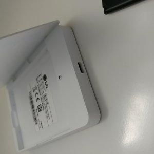

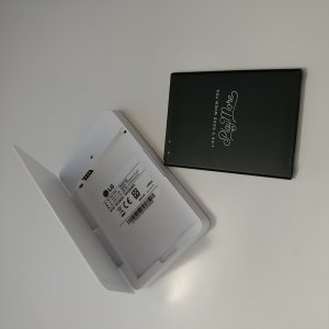

No it's not wireless charging. It's the same concept as rechargable AA batteries, you take the battery out and charge it externally with an external charger. Keeps the phone cooler and battery temps low to prolong the life of the battery (fast charging can reduce the longevity), plus more convenient.
This is the authentic LG charging cradle:
View attachment 284539View attachment 284540

Oh yep duh that's exactly what I've been doing. Unfortunately still get the notification at random times. Usually rebooting the phone makes it go away just to come back half hour later
