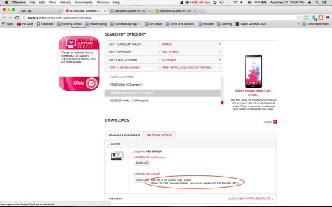

For anyone still dealing with this, I've got a method that hasn't been tried in this thread.
Even though I found it said quite a few places that the LG G3 drivers were required for AFT to work, I went through the LG site and opened their Manuals page for the phone. If you switch over to Software Update to find the drivers, there is a little side-note that says if you install the drivers, AFT won't work!
I have been trying everything in this thread to get my phone connected to my MacBook Pro and none of it worked, but as soon as I uninstalled the LG drivers it popped up automatically the second I plugged it in. So... if you are still having this not-recognized error, try uninstalling the drivers, rebooting, then reconnecting the phone with AFT up. That's what finally (and frustratingly) worked for me.
