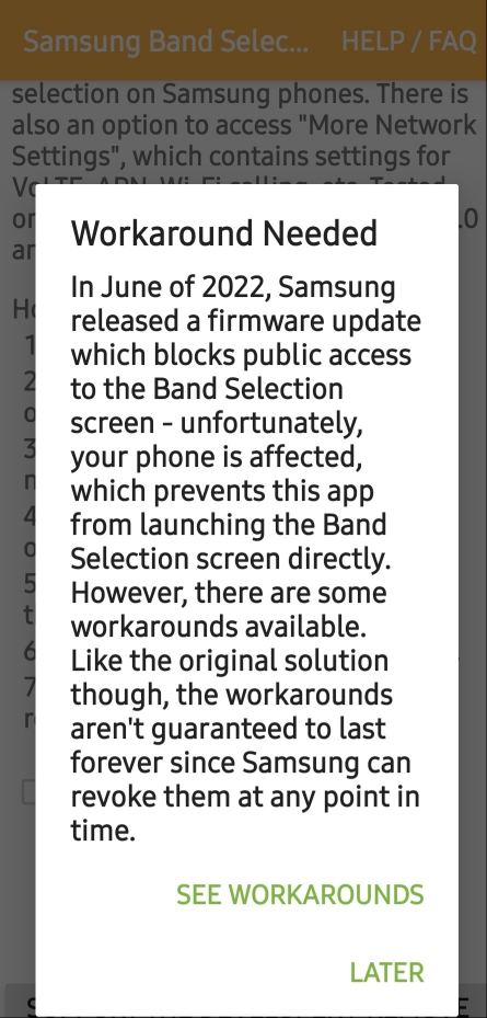

From what I've read Samsung is blocking the options to choose 4G or 5G. I'm sure at the direction of the carriers
Is that on unlocked devices or just carrier ones, though? Either way, that's my guess.
Mine was unlocked. The work around was blocked also. I didn't mess with the ODIN option so don't know about that route
apparently with TMO, you can force LTE by toggling off 5G in connection settings
