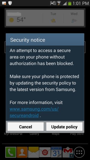

After updating to Android 4.3, I'm getting a new silver shield icon in the notification bar and the security notice below. Does anyone know anything about this? Is it legit? Has anyone tried updating the policy?

Apparently related to KNOX security, I tried updating but still get this notice whenever I connect to WiFi. Can only be disabled on rooted phones, I've read.

I tried updating the policy, but it said I already had the latest version.

FYI. I did a factory reset last night and haven't had this security issue since.
Not the ideal fix, but it seems to have fixed the issue.

I think I may have found a way to go around the factory reset. When it pops up in the drop down menu, long hold the notification until it says to go to app. At that point force stop the application. It has worked so far, hopefully it stays that way.

Try this, it's worked for me so far for the last 10 hours. Instead of going through the mess of factory resetting go settings>more>application manager>all>knox notification manager>then clear the cache and data. I was getting the shield notification every 10-15 mins since doing the update and this solved the problem.

This works temporarily but a restart and the notification is back.
