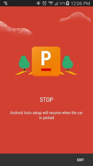

Now I'm getting this screen. I better not need to actually find the parking brake wire.
Is it for a 4100NEX? I'm on an 8100NEX, brake wire grounded, video bypass activated with SET ON.
Yes mine is for the 4100nex. I read somewhere yours doesnt even need an actual bypass. You hold your finger on the screen on a certain area and it turns on the bypass. I need to look for it.

This is exactly what I have done. I have even verified that it works by testing a DVD with the SET ON versus SET OFF.
But Android Auto still thinks I need to be parked.
Hmmm maybe GPS is telling it something, turning it off and then trying to connect just to get through setup maybe?
I think I might just need to get the microbypass as used on the AVH models to set up Android Auto. My car is definitely parked. I really don't care about the video bypass as much, I don't even think this model actually locks out NAV and Bluetooth functions while in motion, just video. However, if I can avoid fishing out the actual parking brake wire I would prefer to do that. I wish there was a way to tell if the unit was actually completely grounded.
