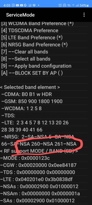

Is there any way to check the available radio bands on a phone from the phone itself? A code? An app?
I think Verizon uses n261 for 5G UW?
