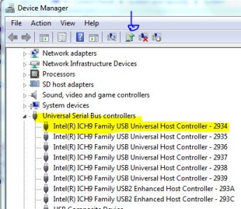

Re: No USB after 4.3 update.
I don't have a PC. The usb ports on the Samsung Smart Dock are the USB ports I'm talking about. Nothing with a computer....
Sorry...didnt read thoroughly
