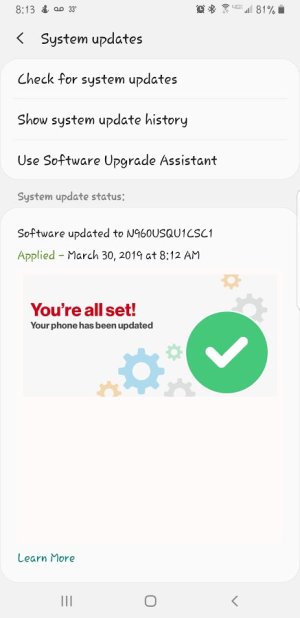

Verizon- pie update?
Update is complete.
I'm on Us Cellular and still am on CSAA and January security patch. I thought if we side loaded the pie update that we would still receive software updates from our carrier? What should I do to get the updates? USCC has released Feb security patch but when I check for updates it says no update available.
