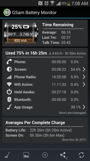

Here is what my battery stats look like. Its pretty bad considering after the time unplugged on the note 2 I would have well over 3 hours of on screen time, more close to 4, that what I'm getting out of the Note 3. I refuse to turn down settings that I didn't have to on an older device just to get more battery. I shouldn't have to compromise. I paid for a "better" device that was more updated and everything. That is what I expected to get.
