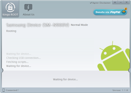

Kingo is stuck on "Waiting for device.." after "Fetching scripts...". Any advice?
i had this as well, swipe open device and accept the id, and run again. i had to do this 3x before the driers fully installed

This is what I did. Plugged up the phone to my computer (windows 8.1) let it install whatever drivers it needed to. Then turned on mtp, after that my computer was able to see my phone as a memory card and actually see my memory card. I turned on debugging. Then i launched the program in admin mode. I made sure that i changed my screen timeout on my phone to 10 minutes so it wouldn't go dark. The program always failed on me because I never knew i had to check my phone so i never changed that setting. Once i changed it and ran it admin mode it ran fine and installed what it needed. You can always try the reset on your device but it may just be something small. if anything is messed up in my post sorry, trying to type with a 2 year old in my lap while shes dancing.
