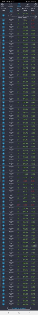

Yes! I'm having the exact same issue. Take a look at this, I scheduled a speed test to run every 15 minutes using the speedcheck app. This is the log showing the inconsistent metrics but the logs on my Samsung A8 tablet are totally stable to expectations over 48 hrs
