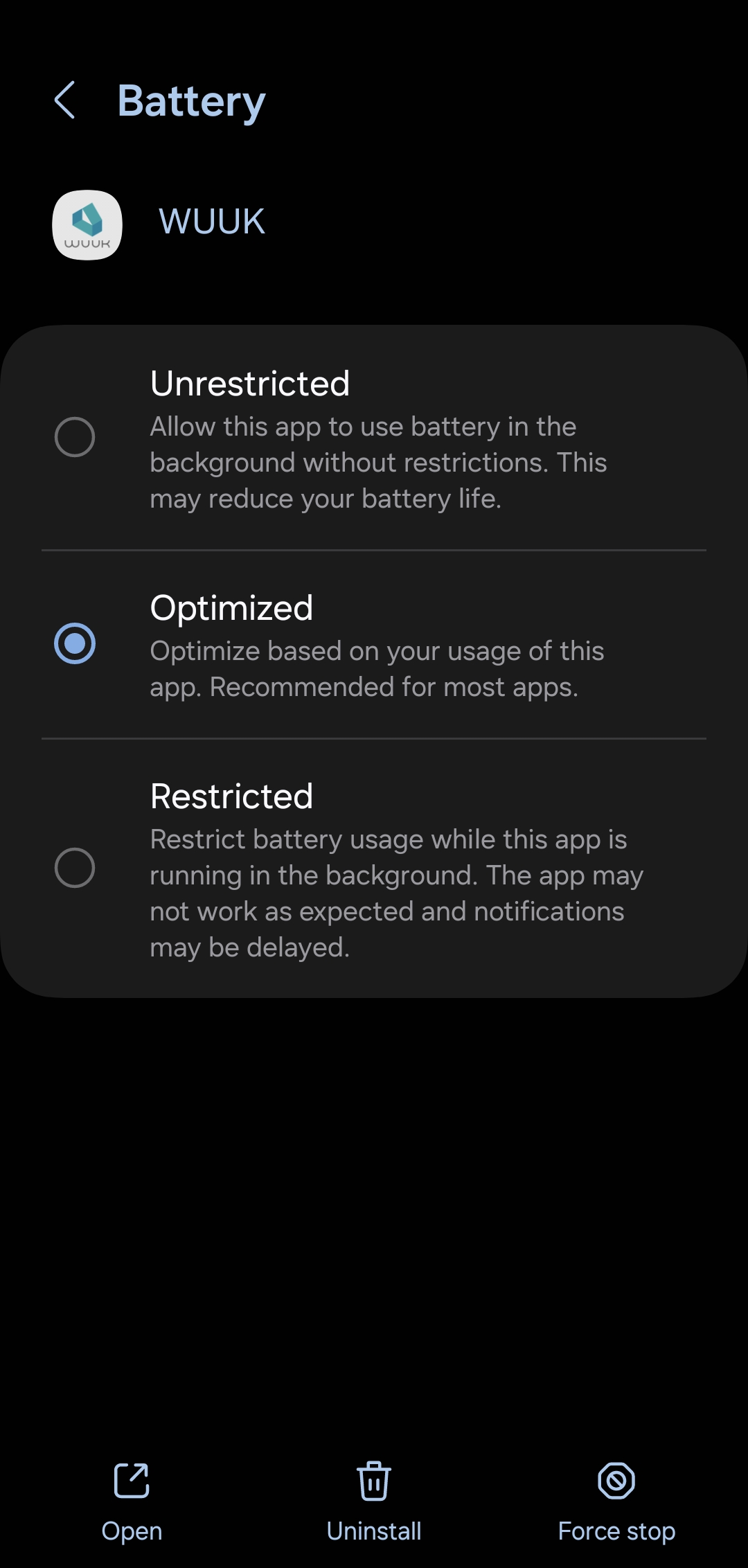

There's a couple things for OP to look at
1. Long press the app >tap info>battery>set to unrestricted
Same place under mobile data set to allow background
2. Device Care open>set that app to never sleeping
I don't use those apps but those selections should help and also when you long press the app>go to notifications tap notifications categories and check if everything ok there maybe post screenshot so we can see what the menu for that app is set at .

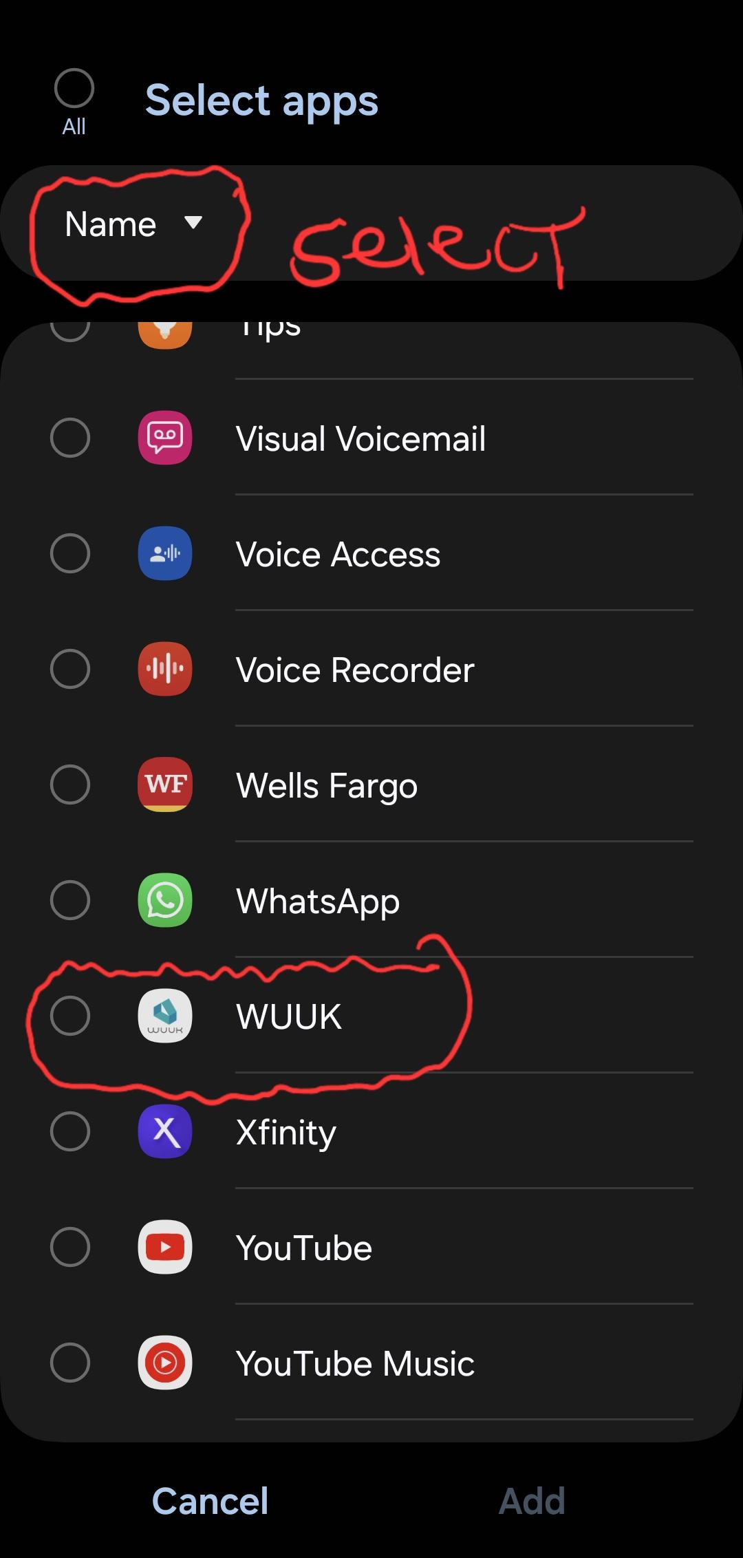

Go to settings>device care
The only thing I can find is "never sleeping apps" where you can add those specific apps you want not to auto sleep. The strange thing is is the wuuk doorbell is not in the list to add with all my other apps.
Tap the + symbol to add apps
Exactly, looks like all my other apps are there but the wuuk app does not show in the list. That is strange
Is this the app?
